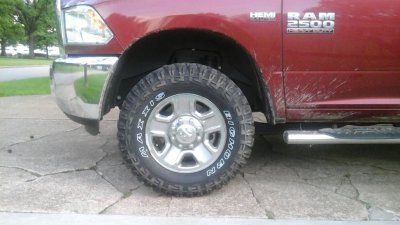

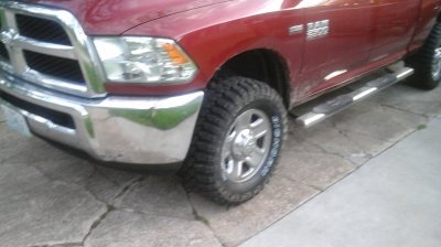

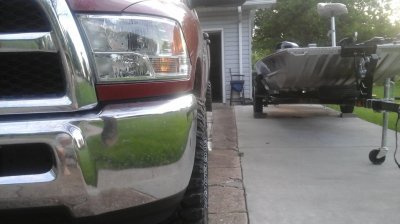

There are always a bunch of threads asking what size tire will fit so I thought I would post this to have the info out there. I tried to have the title be easily searchable. Just like it states I have factory 18" chrome clad wheels. I just mounted some maxxis bighorn mt-762 in 325/60R18 (33.4 × 12.8) vs the factory size of 275/70R18 (33.2 x 10.8) and they do not rub at all. Don't know if they will when the axel is articulating but I don't think they will.
