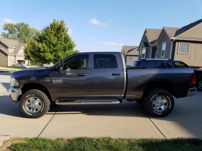

Here is mine with 305/70/18 on tradesman stockers. I do have a 2 inch level spacer with shock relocation bracket. I just get rubbing on the radius arms at full lock both ways because of the positive wheel offset...not a big deal. These trucks look so much better leveled if you can swing that. I have 26k on these tires now. I'm hoping for 40k, but I don't know if they'll go that long. Haven't had lots of snow in KC for a few years, but the small one we got last year with ice under it, they were excellent.20160923_164633.jpg 20160923_164750.jpg
