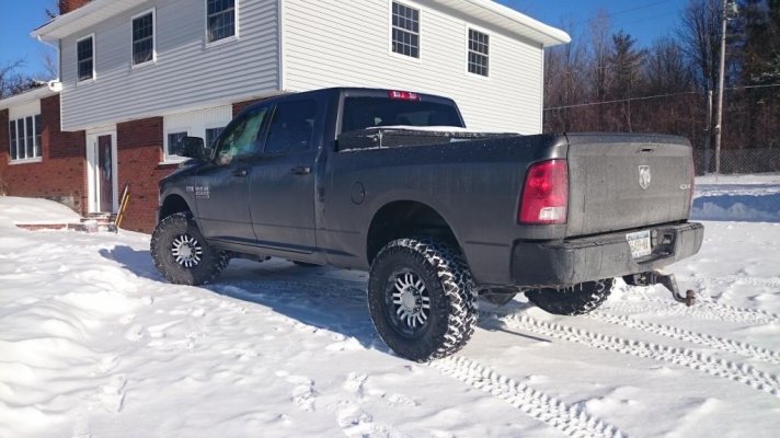

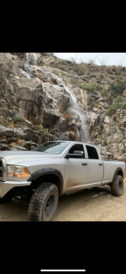

Here's my 2018 2" RCX Level and supreme suspension 1.5" Rear Spacer on 35's
Here's a pic of my 2015 with 35's stock.
f364efcd962b4990ca442fbdc76fce31.jpg I'll see if I have a better pic
Here's a little better one
Here's a pic of my 2010. 2" RCX springs, 1.5" TGC Blocks on 35's

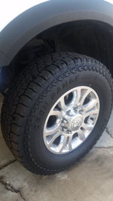

I live east of Carson City, NV about 13 miles and commute daily to work in Reno, NV. The winter driving can get intense sometimes; so when I bought new tires for my 2011 Ram 2500 Tradesman, I wanted the longest rated all terrain snow rated tire (3-Peak symbol on the sidewall) I could get. I ended up getting from Les Schwab a set of their Open Range tires. LT275/70R-18/10 on Thanksgiving weekend. The first Monday back to work had me driving in another winter blizzard storm. I really liked the sure footed feeling this tires gave me over the prior Firestone highway treaded tires that were last on the rig.
When I bought my rig in October 2018 it had some Cooper all-terrains LT265/70R-17 mounted on the stock chrome looking (plastic chrome) steel rims. I was able to to buy a set of "pull-off" stock aluminum rims & Firestones (LT270/70R-18) that came of a 2018 Ram 2500 Laramie. When the Firestones were new they had good and deep tread and I was only driving the 13 miles from Dayton to Carson City, so the winter commute wasn't bad last year. However I had driven about 30,000 miles since I got that last set.
Before the Thanksgiving Holiday break, I drove in two different winter storms during my commute to my new job in Reno. The Firestones had worn off more than 50% of their tread since I had bought them and the tread's performance in the snow was noticeably diminished out on the highway. The Firestones also tended to pick up small rocks and pebbles in the tread and I was constantly digging them out of the tires. The new Les Schwab tires have a more aggressive tread and don't pick up the small rocks and pebbles in the tread like the Firestones did.
Here are some pics of the older Firestones & newer Les Schwabs
