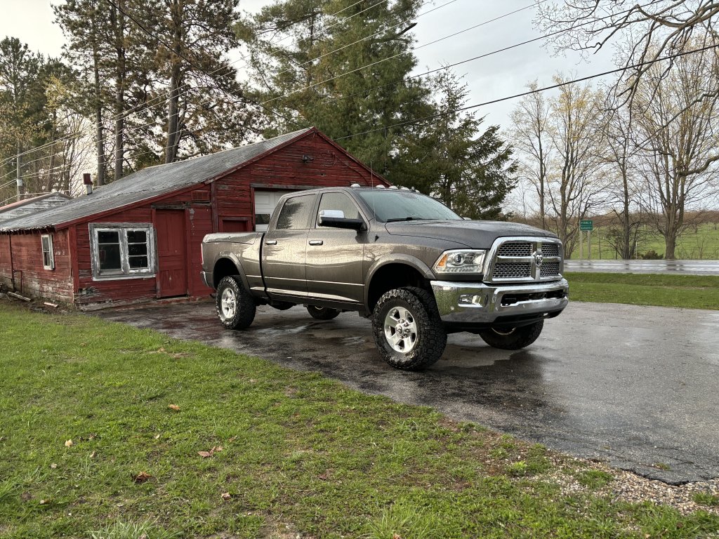

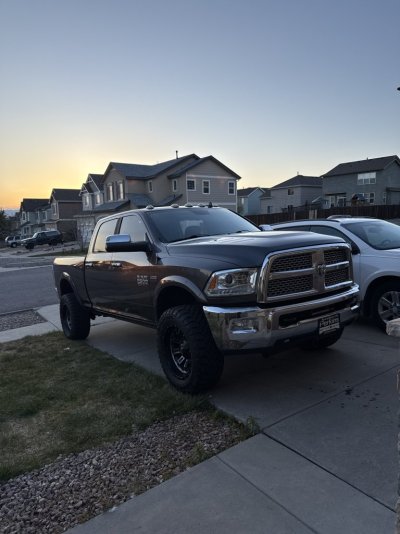

Hello everyone I have a 2015 ram 2500. I’m running 35 inch tires. I wanna know if anybody else is getting 8 to 9 miles to the gallon. I spoke with another guy that said he’s getting 14 to 16 and he’s got a 2020 ram 2500 with the 6.4 hemi and I have the hemi also 6.4

You wont do as good of mileage as the ‘19 and newer ones with the 8 speed trans. Dont even bother comparing to them.
I have a ‘16 power wagon, and have gotten around 12 mpg for the last 130k miles since it was new. I think i squeaked 13mpg out of it once in its life, but never more. It does have 35’s on it, but the mileage didnt really get any worse.
You should be getting somewhere around 12 at least, unless you drive like a complete @$sh0le lol
