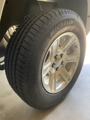

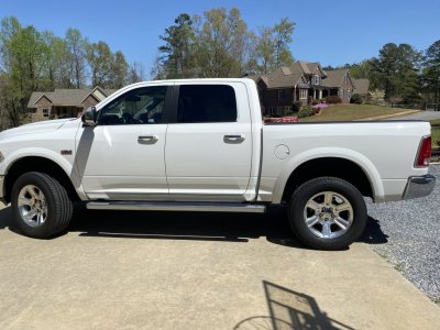

Finally got ‘em installed,pics added to first post.
Initial thoughts, they sure are smooth and ride as nice as I was expecting.

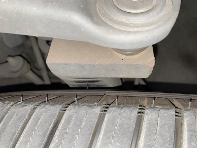

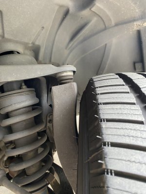

How big of a spacer are you running? And whats your UCA clearance like? I'm about to pull the trigger on a set of 35x12.50x20s for my truck with the same stock wheels. I've read various sizes needed for a wheel spacer. I don't want to go any bigger than necessary.

No spacer needed sir! I’ve got about a finger width of clearance, absolutely NO RUBBING. Didn’t need spacers on my previous 35’s either (Cooper AT3 XLT’s).
Tires that spec out to no more than 12.1” wide when mounted on a 9” wide rim will fit without needing a spacer.
A lot of 35’s spec out to 12.5” when mounted on a 10” wide rim but on a 9” rim they will measure 12.1”. Toyo MT’s for example, spec out to almost 13” wide..........
General rule of thumb: For every 1/2” of rim width, the tire width changes .2”
Check the tire manufactures websites, they list all the measurements and most will indicate what rim width they used for the given spec.
I’ll snap a couple of clearance pics in the morning.

Knuckle clearance for those interested. No spacers with stock 20x9’s. Not the best pics, I’ll get some better shots if requested. The clearance is tight but there is absolutely NO contact. I had my previous 35’s for 32k miles and no contact, these have a smidge more room (I can just about get a finger in between there........yes, I did type that and expect the jokes that follow ;))
Note for pic #2: the little “clean” mark is not from the tire rubbing, you’ll notice there are NO marks on the tire from contacting the knuckle. Had these on for a week, already put 1k miles on them.
