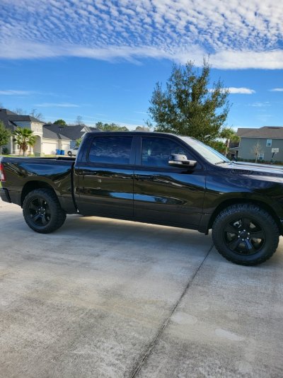

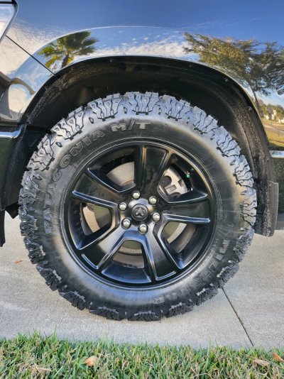

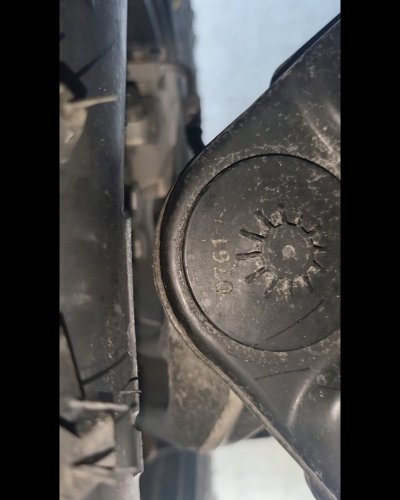

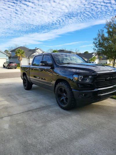

I havent seen much of anything on 35s fitting on Stock Bighorn so here you go. I have a 2021 Bighorn on Stock suspension no offroad package and I was able to fit 35/12.5/r20 Patagonia M/T on stock rims with only a little rubbing at full lock in reverse. I think if you remove the mudflap then that will fix the rubbing. The tire clears the UCA by about a 1/2 inch.
