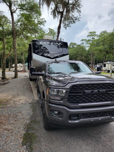

By the limits I'm guessing you mean payload capacity? The payload on my 3500 is 4058lbs.
You can plan on 20% of a fifth wheel's GVWR for the pin weight. The GVWR on my fifth wheel is 12,200lbs. I actually weighed my rig at a CAT scale loaded for camping by myself. The pin weight was 2220lbs.
