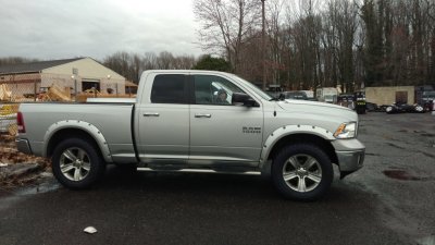

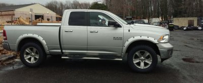

I just drove a friend of mine to pick up his truck this afternoon. He has a 2014 quad cab with sport wheels and just had Rough Country 2" leveling struts installed today. He also had them install new 35x12.50x20 Mickey Thompson ATZ P3's. No wheel spacers needed....no rubbing at all. Here's a pic of his truck:
NJ4X4
Aug 1, 2014
795
581
South Jersey
Not sure why it posted the pic above 3 times....I only attached it once!
