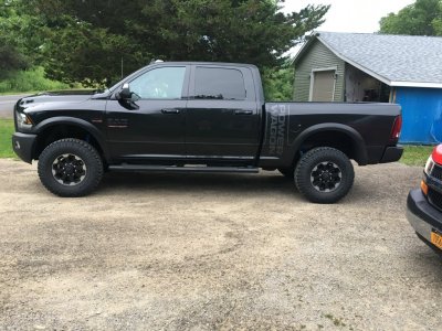

View attachment 157208 View attachment 157209
