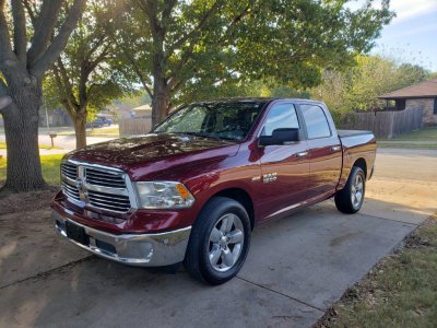

I'm a new Ram owner. I just got a 2018 Ram 1500 Lone Star edition with a 5.7L Hemi, Crew Cab. I just got the truck last month.
I'm a 3rd generation Ram owner.
The truck has ~35,940 miles on it, and I took it to the dealership to have the 8.4" screen replaced for a delamination bubble in it, and for a rear bench hinge that gets stuck in the folded position.
Before the warranty runs out I'd like to check for common issues that I might not be aware of yet. The dealership told me they could fix any issues I could find, but they can't go looking for issues.
To that end, I was hoping that you all might be able to help me. What are common issues that you see reported? What warranty claims have you filed on your trucks in the past.
Any helpful advice you can provide would be appreciated.
