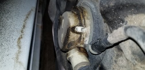

This is what is leaking if I remember. It is part of the tank / non serviceable. Tank will leak if on a hill and smells like gas after filling.
Also stalls when tank is filled to the point the pump shuts off.
Stalls under power momentarily then continues at highway speeds.
Will stall and shut off truck if stopped and rpms drop below 1200.
Will intermittently stall when tank is at various levels.

kmrtnsn

Check your evap cannister. Sounds like it's full of fuel.

My solution was to replace the canister, purge valve, and filter. No problems since.
