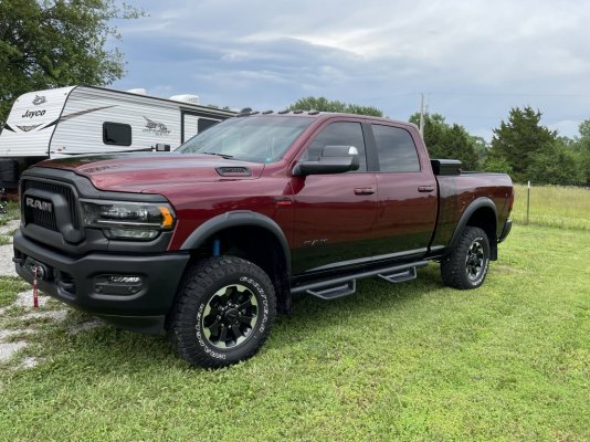

Alrighty that same old question over and over. Lol

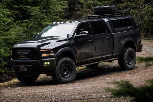

Anyway 37x13.50x17, who has them and any on stock suspension? Or what did you need to do lift wise?
Pictures ?

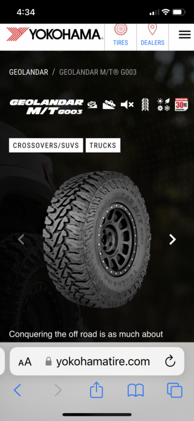

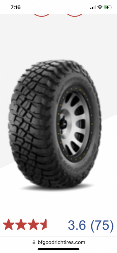

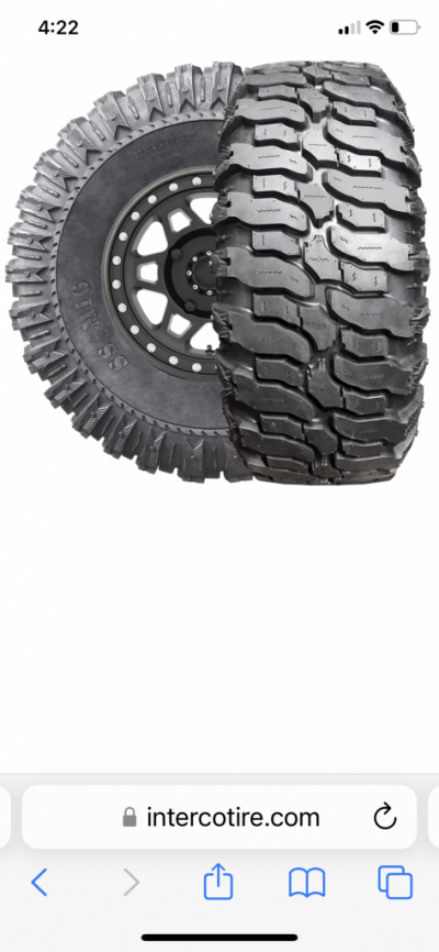

Looking at 3 different tires for my wagon, BFG KO3, Yokohama MTs and maybe Intercos SS M-16s but they only are in a 13.50 wide instead of 12.50.
I would rather not lift it over stock so Iam leaning to the BFGs since it sounds like they run a little small but like the idea of the intercos for the different look they offer.
Anyone have info on them? A good tire? Never ran them before.
Any input on the Yokohamas is welcome as well.

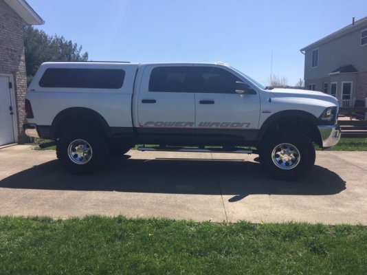

2016 with Thuren 1.5" front coils and 1" rear coil spacer. 37x13.50R17 Ridge Grapplers on 17x9 Pro Comps with -6 offset. Trimmed the plastic on the rear of the front fender line and cut and folded over the pinch weld. Haven't had the chance to really flex it out though, but normal driving it's fine. The fronts rubbed hard when turning just sitting in the shop prior to trimming. Yes, I know the offset is way off from what is recommended but I wanted these "old school" shiny rims and couldn't find anything like it with a different offset, nor wanted to pay twice as much. Also always liked wider tires so why I went with 13.50's.
