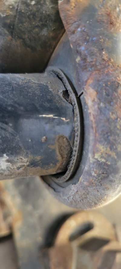

Sway bar. That's the weird one. The dealer did mention they replace them alot. Mine has bizarre etching/corrosion at the bushing. I can't feel play, but they are definitely wearing out. It almost looks like crevice corrosion or alloy pitting where just some parts of the metal burn away like a cannon fuse and other parts don't. Very weird.
At this point it's 250$ for sway bar links. Or 700$ for the entire bar/link assembly. Trying to picture what is best at this point as I'm no millionaire.
Anyone else seen a bar wear like this?? Disregard the standard rust. This is a northern Ontario truck. Rust is part of life.

If you are sure the links are part of the problem then go for it on the $250 for new ones. Otherwise I'd just remove the thing as there's no way I'm paying $700 for a new part that you don't *need*.

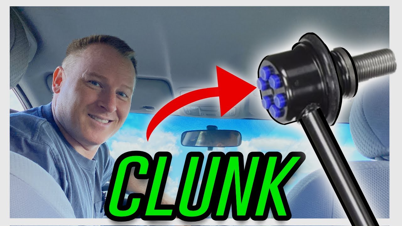

Here's a YouTube video I found while searching front end noises. I have no affiliation with this guy at all but the sound he recorded sounds 99% match to mine:
I do enjoy having the sway bar because I drive long secluded highway with no police. Because it's long, boring, and unpatrolled I drive it briskly. Having the body roll support for corners is welcomed.
I found some aftermarket links finally just now and they don't use a ball and socket joint but rather a polyurethane bushing joint. Same price as the dealer so I may order them up instead. It the dealers are going to crap the bed every 5 years might as well try something else.
