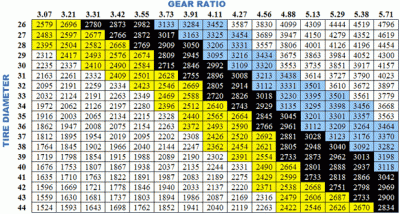

Hi everyone. I found this forum site gives the most feedback to the people who are posting so I thought I'd start here. I recently bought a 2015 ram 1500 Express 3.6L with the 3.21 gearing used with 50k miles. Even though a hemi would've been great it was never an option for me due to a financial stand point and also only being 17 years old. I ended getting some birthday money and have been saving some extra money and I want to put 35's or 37's and a 4 or 6 inch lift to give my truck some stance. I see a lot of people give the 3.21 gearing tons of ****. But there is the few odd people out there would have 35's or 37's on their ram with 3.21 gearing. But those people using 3.21 gearing have the hemi with 3.21 gearing. I've realized that ram's newer V6 engines like mine have a pretty substantial amount of horsepower compared to older V8's with big lifts. I'm more concerned about the gearing than anything. Can anyone help with this decision on what to do? Thanks for any feedback.
As someone who owns a 2017 with a 3.6 L V6 and 3.21 gearing, I gotta say...
...dude, are you high!?
Okay, let me explain.
Yes, the latest 3.6 L V6 engines (including mine) has 305 hp. That's a lot of 'oomph. However, the 3.21 gearing plus big meats? It'll gut through it, but it's gonna play hell on your fuel mileage, cut down a bit on how much you can haul (in the bed or on the hitch), and climbing any steep road is suddenly gonna suck - bad.
A V6 with 3.55 gearing would be doable (I think), but 3.21 is gonna be pure yuck for that kind of thing.

I have the 6 speed 3:92 gears and the 5.7 and it’s a complete dog. Wont even spin the tires off the line. Do I want to put 4:56 in like the chart calls for...absolutely. But your looking at almost $500+labor for each axle to swap gears. Hopefuly when my motor blows and I put a forged 6.4 in it it should be ok.
But to answer your question...go with what the chart says for gear ratio. As long as your geared for your tires, you will be ok.

I guarentee, id never be happy with 3.21s on stock tires
I test drove a RCSB 3.21/8 on stock tires. Quite honestly I couldn't for the life of me figure out what all the hubbub about the 8 speed was about. Yeah, you have that really low 1st gear, which the truck uses for what, about 3/4 of a second? Then I think second in the 8 is real close to first in the 5/6 speed. From there on, it was just a bunch of shifting.
But feel is subjective. And I'll be the first to admit my butt Dyno is as totally worthless as everyone else's.
This is my opinion, and it applies to both the 6 and 8 speed: stock tires nothing less than 3.92. 35s, nothing less than 4.10. 37 s, othing less than 4.56s. The chart is correct!
For lack of a better analogy, Your truck is happier on lowish gears. And gears should match tire size.

Just remeber folks, the 8pseed has no advantage once into overdrive, same 0.67 ratio as the 6 speed. The 8 spd helps out of the hole with deeper ratios and a closer spread but once above 50 or so and crusiing the gearing advantage is gone. My truck will get into 8th around 48mph if I’m driving “easy”.
To the OP, all really depends on what you’re willing to put up with. You can sure as heck throw 37’s on your truck just know and be prepared for a slower truck that will probably shift alot and drink alot if fuel. Be honest with your expectstions and you’ll be fine.
