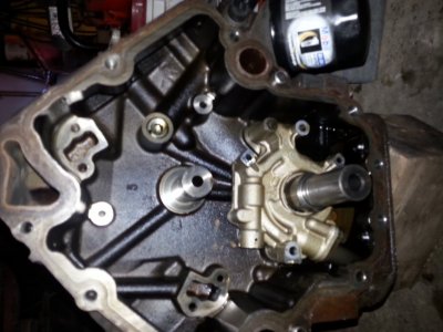

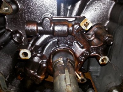

This the more miles replacement engine.

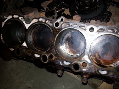

My original engine.

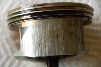

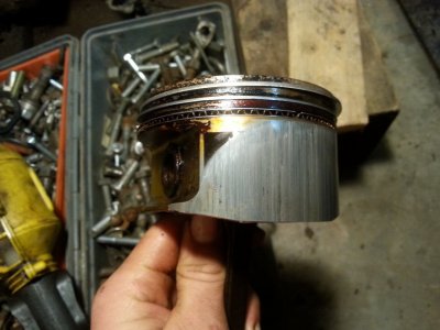

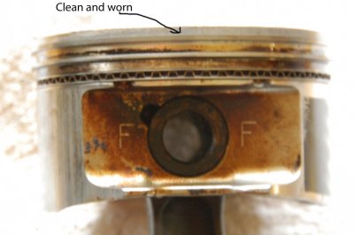

I think i have found the problem.....:roflsquared:

Yea, but not developed in to a rattle yet..... Also the wristpin seems to be about .030 off center.

The wrist pin is tight on the rod and the rod is able to move side to side on the pin in the piston.

So i have been after this tick for a year now and i finally fixed it. I have done timing chains, lash adjusters, replaced both heads etc..... It turned out to be piston #1. The wrist pin was bored of center .0030. So i replaced it and got the engine and heads cleaned and the #1 bore honed. And put it together. I ran it without the spark plugs in to get oil kinda throughout the engine. Start her up and she now runs smother and quieter then ever!!
