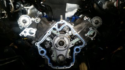

Here is a pic of my 2002 1500/4.7L after installing head gaskets.
Mine took the one-piece gasket.
