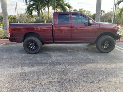

6” should get new UCA because it uses spring preload to get the last little bit which puts it above what “stock angles” are. Any UCA for lifts readjusts the ball joint angles which you don’t need for a 4” kit because 4” kit keeps stock angles. I have a small kit using front struts and rear lift springs so I’m lifted 3/1.5 and 35s
