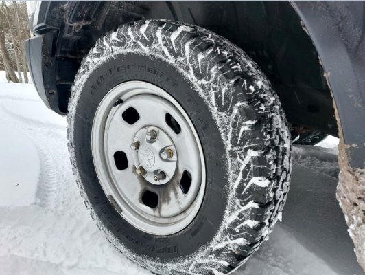

For me, narrow winter tires with bfg ats and 4wd high when I need it.
I use 245/75/17 E-rated BFG AT KO3s. They work great in deep snow. :cool:
Although they would have no problem with that laneway when new, they would need to be aired down after a year or two of winter use.
