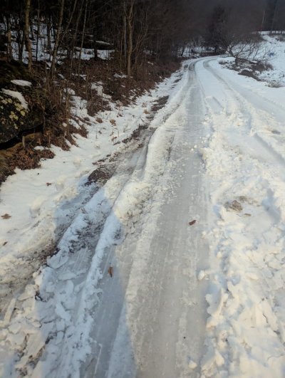

This is my driveway and the ditch.

Looks like compacted snow that turned to ice overnight.

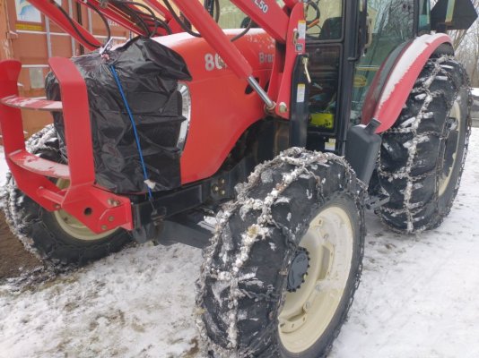

And this is what has no trouble in the driveway and has pulled a few vehicles up, and also acted as the brake for others when going down
