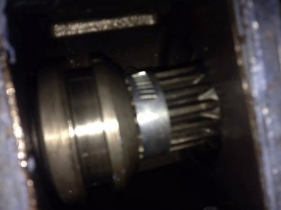

Fixed

He slide the collar over to join the two axle shafts and then used a hose clamp to stop the collar from sliding back and forth on the shafts.

Exactly what merc said, you may have a vacuum leak or a stuck fork shaft. Take off your 4x4 unit from the front passenger side axle and see how it looks inside. Take some pics of it I can tell you what's wrong most likely now that I've had the problem myself.
