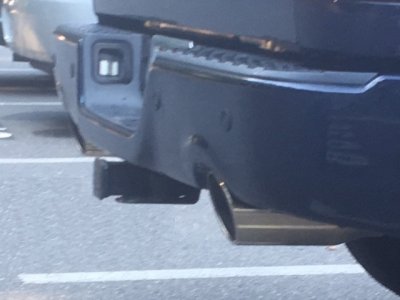

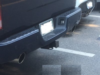

Moe's Performance 5" tips.
Notice length of the 5" diameter--that gives a nice almost side pipe sound to the exhaust.
Neighbor has them and they even make the stock exhaust sound better.
