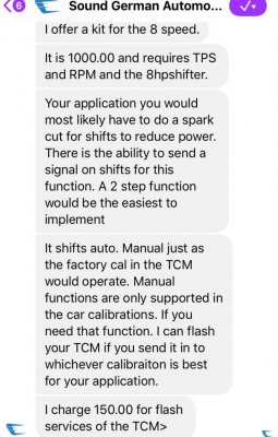

I messaged sound German automotive and said I’d need a TPS, RPM and shifter. I know the acronym for RPM but RPM?

He means it needs an RPM signal in addition to the TPS signal.
Someone has done a 4x4, that's how it's known that its a bit easier in driveshaft terms. Couldn't tell you who but it makes sense though.
So apparently Ram trannies don't have manual shift feature, interesting I didn't know that. From your 2015 you'll need the trans and shifter (rotary knob). You need to get under and compare t-cases and the front & rear driveshafts to yours.
