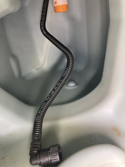

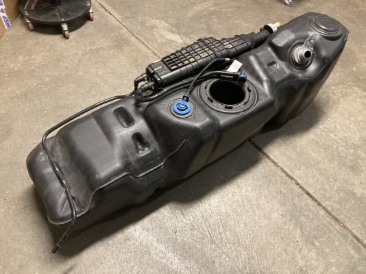

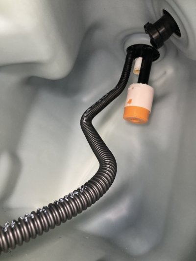

Hello all,
I am trying to find some information on my dilemma. About 4 weeks ago I started to have a fueling issue where I would start fueling and after a few minutes or less the stations gas pump would click off like I had filled the truck. I maybe got a gallon or two in. After doing research found that it is a common issue. Armed with this information I set out to see what could be done. I came across an article saying it was a known issue and that there is a new style fuel tank that would need to be swapped in. The article had a picture of it but didn’t provide a part number. I found a used tank with only 2k miles on the donor truck for $150 US. Same 26 gallon and the seller was throwing in the charcoal canister and a fuel line. Bought the tank. Tank looks identical to the new style that was referenced in the article to fix the issue. Got it home and noticed that there’s an extra connection inside the tank.
All photos I found show no such connection. My truck is a 19 express Classic. Donor truck is a 22 new style. Any idea what the connection is for and will I be able to use this tank.?

Well I can say that the tank from a 2020 5th gen does not fit. It was exactly the same as my current tank with the exception of the blue vent valve being at 45° instead of 90° and the area just left of the valve in the 1st picture I posted.
The 5th gen tank area is raised and my 4th gen is recessed. I am assuming for the accommodation of the frame.
