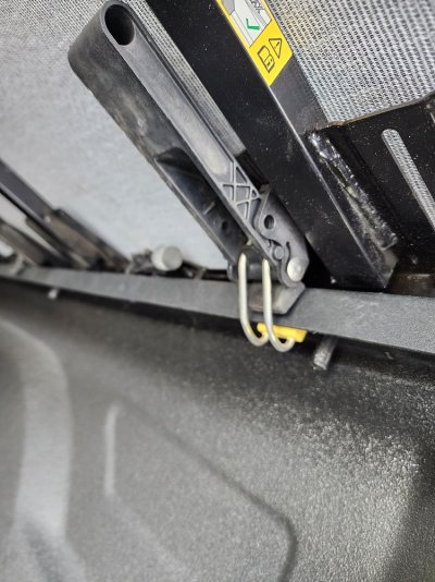

Picked up this tonneau cover: 82215863AB for a 2019-2023 Ram 1500
Installed it on a 2022 Warlock (5'7 bed), it fits, but the clamps are loose.
Correct part number for the Warlock:
82216335aa for a 2020-2022 Ram 1500 Classic
You can probably make the clamps work properly by fitting a piece to close the gap (which is what I'll do), that way it will clamp on tight.

Update:
The fitment is spot on, but the clamps don't tighten fully. Therefore the cover can slide 2 inches forward and backward (does not move from left to right)
I put a "shim" for now on all 4 clamps and it no longer moves back and forth.

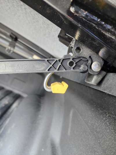

Found the proper cover this morning.
Locks in properly and more importantly, it doesn't move at all.
I'll put the 5th gen one for sale.
Clips are different too, shown below:
