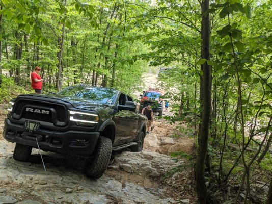

Here's a little 5th gen (Pete from PW registry)self recovery pic with an assist from @IRSmart from an outing we had78aa2dd6333531d9ff59c397970ac19b.jpg

A little back story to this picture. Gray power wagon had a full send it moment up a very steep and bouldery hill. At one part of the ascent, he clipped his rear bumper on a rock, pulling it out, then when he decided to abandon mission and back down the hill, the bumper caught the same rock on the other side. He would have folded his bumper under completely if he continued to back down, so we all decided down was no longer an option...he HAD to finish this obstacle.
the next issue was that as he started to climb, a rock was protruding towards his rear passenger wheel, and at one point was completely between the tire and the bedside, INSIDE the wheel well. So to keep him from sliding backwards, I positioned myself at the bottom of the hill and snatch blocked to a tree to his left, and hooked up to his hitch shackle. I kept constant pressure on his hitch as he winched himself forward, preventing him from continuing to slide passenger into the rock. This pic is me about to hook up to his hitch, you can make out the snatch block on the ground.

Hell Yeah Fellas. You guys know how to have a good time lol
