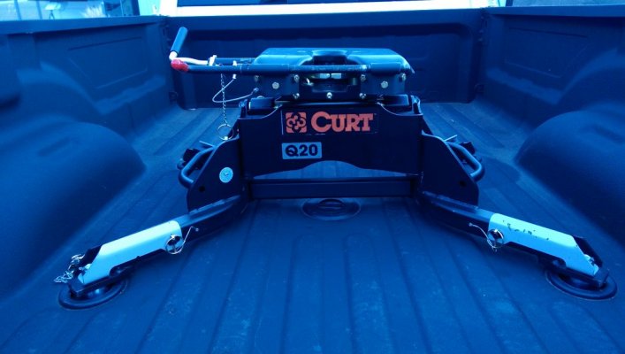

Well you can spend a ton of money on one of these units. In the end they all accomplish the same task. The OE mopar units from what I have seen are made by CURT. Thats what I have, it works fine. I will add though this unit with the adapter legs is built like a tank, and accordingly is freakin heavy. I did upgrade the pin box on my fifth wheel to help with the harsh bumps you will always encounter out on the road. There are units out there have air bags or springs in the hitch, which I dont doubt would ride great, but I didnt want to spend $3-5K on one.

Thanks for the reply. I bought a used a Demco that mounts on the gooseneck ball to tow my toy hauler home after I bought it, it was only about 175 miles. My 6.4 Hemi 2500 got it home but it was straining.
While the Demco seems well built, I like the idea of the 4 point puck system, it just looks more robust.

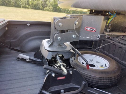

I have an Anderson hitch and love I! An attachment goes on the king pin and attaches to a ball on the hitch and there is absolutely NO chucking at all. Weighs in at about 50 lbs and is rated for 24k lbs, and was around $1000.00 Canadian, so about $20 American lol.
Check it out on the Anderson hitch websit

I have been using the Andersen Ultimate for over a year and really like it. The weight of it makes it easier to install and remove for just one person.

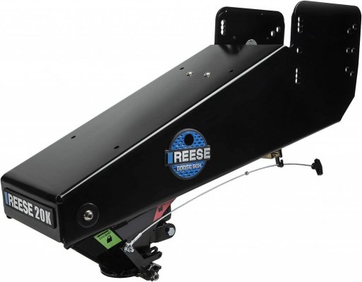

Me and I was staying under 20k I would go with a Reese goose box review are great and people I have talked to says same they pull better and smoother than a 5th wheel I can see why got that connection point back down lower at the bed instead of up high like the Anderson or 5th wheel. If I pulled mine more than my little weekend trip yeah I would have one In a heartbeat. DO NOT GO OFF THE SAMPLE LISTING THERE IS DIFFERENT PIN BOX#'s make sure you get right pin box# for your 5th wheel https://www.amazon.com/Reese-94720-...mzn1.fos.17f26c18-b61b-4ce9-8a28-de351f41cffb61KRVAKjIcL._AC_SL1500_.jpg

I am also going to install the Reese Goose Box (16K). Not cheap, but the ride is supposed to be incredible and the safest you can find. Plus, the ability to pull out the goose ball and have your entire bed open is a dealmaker. Otherwise you are pulling (and storing) a 200+ lb. hitch.

OP here. I looked closely at the Anderson but after seeing a couple catastrophic failures I decided to go heavier. From what I understand Anderson addressed those issues but I can't get the image of a 16,000 lb 5er sliding forward into the cab.

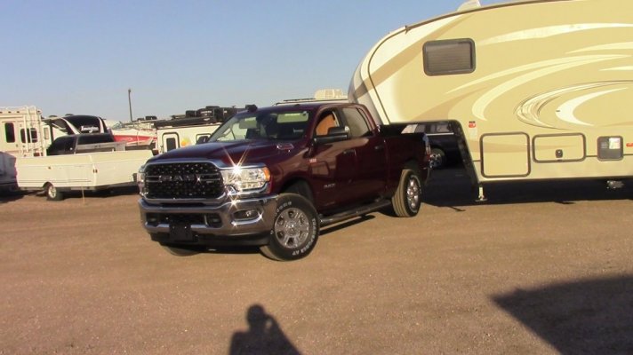

2022 ram 2500 6.4 , Cougar XL with shaped cap , Curt A 2500 hitch with no slider . I can turn close to 90degree with NO cIMG_0856.JPGab contact .

the 5th wheel hitch is a Reese 19k sidewinder (came with RV). I have the sidewinder feature (rotating point 22" back from pin) locked out so that the front pin is the rotating point . If I find I need more cab clearance I can always get the Curt matching "wedge" , move the rotating point back 22" and have even more cab clearance .
