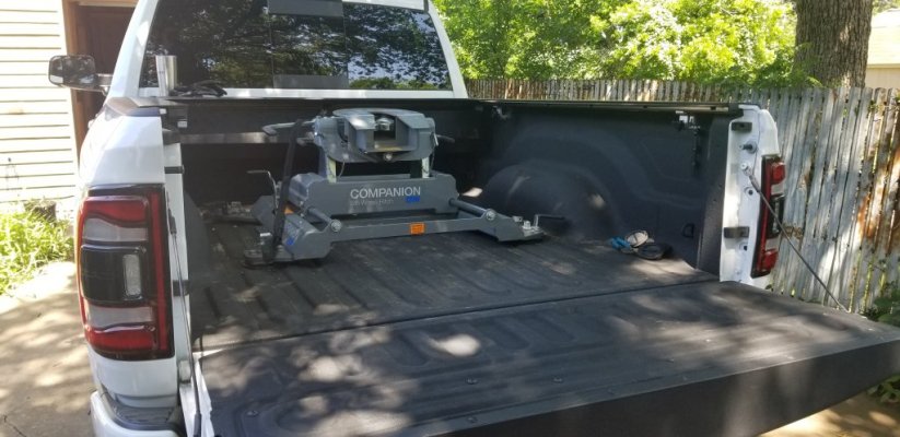

mine came with it too. I use a B&W 5th wheel hitch that fits in the factory pucks20230517_111547.jpg

mine came with it too. I use a B&W 5th wheel hitch that fits in the factory pucksView attachment 540697
I have that exact same one - and have learned I don't need it for the fifth wheel I occasionally have to move, I can leave it in the full-forward position and get well past 80° which is more than enough (it's my FIL's). As heavy as it is I used it all winter for weight in the bed, but I may get rid of it and buy the fixed setup, just for the weight savings and to make it easier to get in and out by myself.
Kinda hard to part with it yet though, since I only paid $800 for it used and it looks brand new. I know they're something like $1800 brand new.
