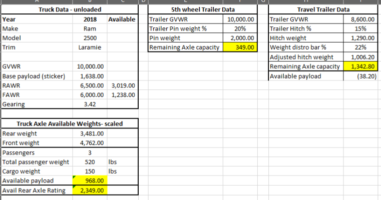

I sat my wife down this weekend and laid the math out for her because she's been adamant that we go back to a fifth wheel even though I've explained that I specifically purchased this 2500 for a travel trailer. She found a short fifth wheel that she liked that has a GVWR of 10,000 lbs. Truck should be plenty big enough to tow it.... she says. Ok fine. Let's work it out.
These are the REAL scaled numbers from the truck in my sig. All said and done, ignoring payload I would be within 350 lbs of my rear axle capacity on a 10k lb fifth wheel. I finally got it to stick... most 2500s are designed for travel trailers and not fifth wheels. On an 8600 lb travel trailer we are barely over on payload but have plenty of axle left. The same doesn't hold true on the 5th wheel.
