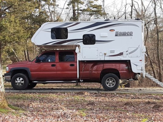

I mean we couldn't have hauled this beast with anything less than our dually. OK not a 5th wheel so different topic but I do have plenty of experience with big *** trucks. Sure it is a bit bouncy unloaded, it rides like a truck. No air suspension, plus it's an '01 so not exactly full of the latest creature comforts. But the husband daily drives this truck most days! It's harder to maneuver because of the DRW, but a SRW is probably plenty for most towing and isn't any bigger or harder to park than a 3/4 ton.

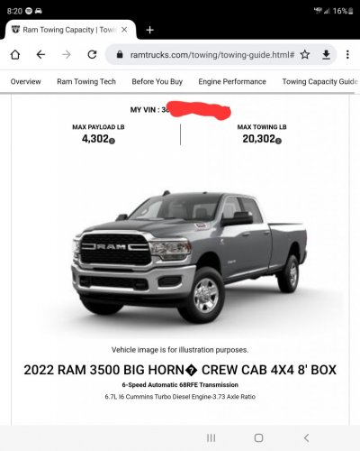

Again, that's not likely unless you get a standard cab with the diesel 3/4ton or a gas 3/4ton. The chart below is from the 22 Ram sales brochure, the capacity listed are with no options and no passengers. My 22 Limited Longhorn CTD Megacab with Ramboxes only has a payload of 1750lbs. It's listed on the sticker on the drivers side B pillar.
Can a 2500 diesel haul more than it's rated for? Sure, and folks do it all the time. There is really not that much difference between a 2500 and 3500 SRW. The legality of doing that is, at best, questionable. In an accident, you may be found liable because of an overload.
In the OP's case, where he's buying a truck to haul a fairly heavy 5th wheel, why take that chance (assuming he buys a diesel)? If he already owned a 2500, I could maybe understand the desire to push the limits. But there is only about $1000 difference between a 2500 SRW and 3500 SRW. And unloaded, the 3500 will be a stiffer ride, even with factory air suspension. Those are small prices to pay for the peace of mind, IMO.
