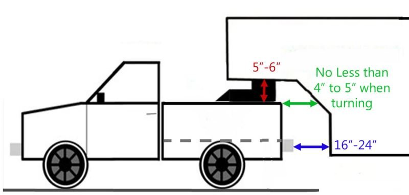

Thats my understanding, but I've heard that people have hit their beds when the truck and 5th are on different incline planes, which is what I'm worried about because of the creek crossings I have to go through (which most people wouldn't have to deal with under normal driving conditions - other than I've read a few people say they've hit their bed going in/out of gas stations). Whether thats predominantly a result of improper clearances, I'm not sure. Heres a crude modification to the drawing you posted. The red representing the bed as if the hitch weren't slid back how it could hit, but would clear with hitch slide back represented by black bed.

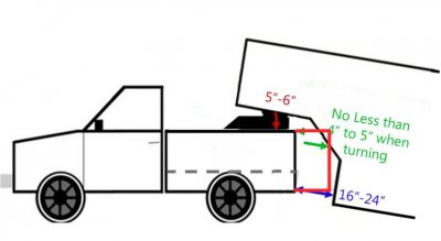

In the drawing, the 5th wheel's kingpin is centered over the axle. A slider hitch will move the trailer back (towards the tailgate) about 8" to 10" depending on the slider hitch. The unmodified drawing is correct for a SB truck.
I guess you won't really know how things will measure up until you take delivery of the 5th wheel?

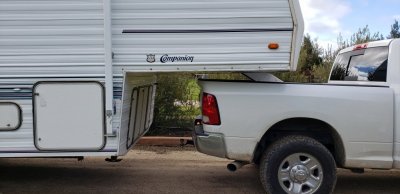

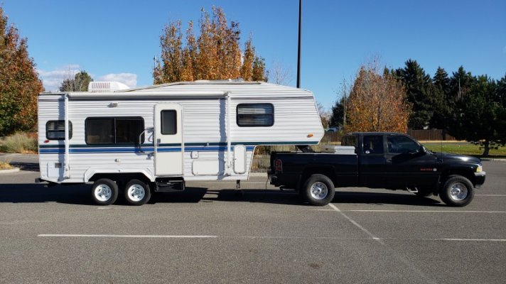

Here is a picture of my 5th wheel and my '97 Ram truck. I pulled this successfully, without issue. The only trouble I had was the fear of the trailer hitting the toolbox, so I sold the toolbox.
Since this photo was taken, I have lowered the hitch height by one notch. This allowed the trailer to ride more level. You want at least 5 to 7 inches between the bed rail and the fifth wheels overhang.
I was considering buying a co-worker's Ford Powerstroke and I mocked up the hitch height with blocks of wood in the back of his truck. You can see by the picture his truck was too tall for my trailer. My trailer has a spring over axle lift and it still wasn't enough for his truck.

The point of the picture I modified was to show if you have 6" of clearance at the hitch, you will always have 6" of clearance at the hitch. But if the truck is flat and the 5th is on an incline, that clearance will decrease near the tailgate, increase at the nose, but always stay at 6" at the hitch (hinge point). Whether or not this is something I really need to be concerned with, I dont know.

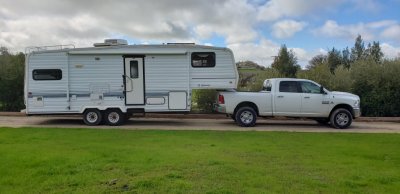

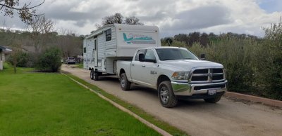

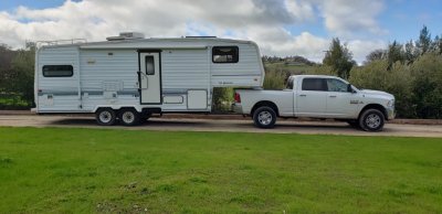

Got the 5th delivered last week and hitch installed this weekend. I'm not too concerned with my initial worries, but I obviously need to lift the 5th. Here's a couple pictures with the hitch forward and back. My driveway isnt perfectly flat so it was pitched slightly with one side (the side closest in the pictures) about 4" from the bed rail at the nose and 2" at the tail, and the other side was 6" at the nose and 4" at the tail - I'm pretty sure I measured with the hitch forward, but I dont remember. I have a spring over kit coming in the mail should lift it 5 - 6 I think, and I can raise my hitch another 2 - 3 inches if needed. Hopefully that'll get me high enough. 20190303_141146.jpg 20190303_141352.jpg 20190303_141340.jpg

I think you definitely need to lift the trailer. I bet your axle flip will solve the problem.
Nice looking setup.

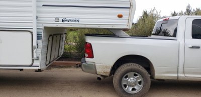

Finished up the axle flip and what a pain in the ass that was. Not all that difficult necessarily, but jacking the thing up was a **** show and comprised about half the time spent. Absolutely no good place to Jack from, and felt sketchy as hell.
Anyways, the math says I should have 6" of lift, I didn't measure anything before/after on the rv, just the thickness of the axle, springs and perches, but it seems like i got about 6-7 inches.
Also moved the hitch up 2inches to the highest setting. I'm now at, from the bed rails, 7" at the nose and 6" at the highest part of the tail gate. I didn't think to measure frame to ground, but it seems pretty level as is, maybe a little bit nose high, but it's hard to tell. Overall height is about 11 1/2ft at tallest part of the roof and about 12ft at the ac cover. I have to do wheel bearings next weekend, then I'll finally get to tow her "around the block." 20190310_144953.jpg 20190310_145012.jpg 20190310_145128.jpg

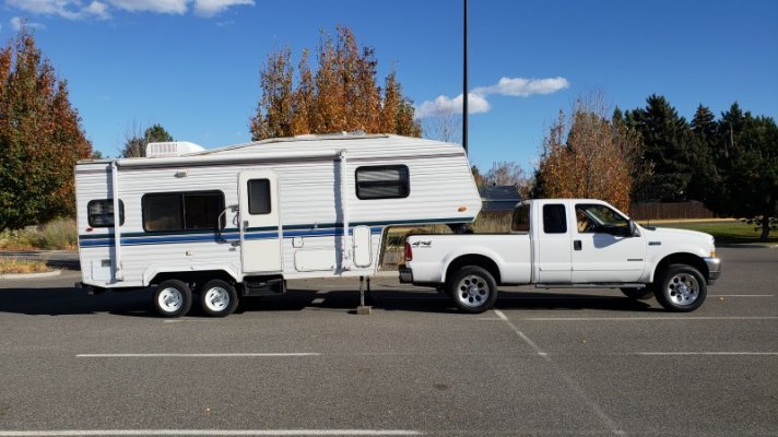

I received the bolt on bracket kit for my hitch yesterday. I pulled the trigger on the kit vs drilling into my 3/4 frame.
Hopefully it goes well. :hmm:
Edit - It's installed. I'll hitch up to the trailer tomorrow and see if it all measures up.

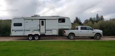

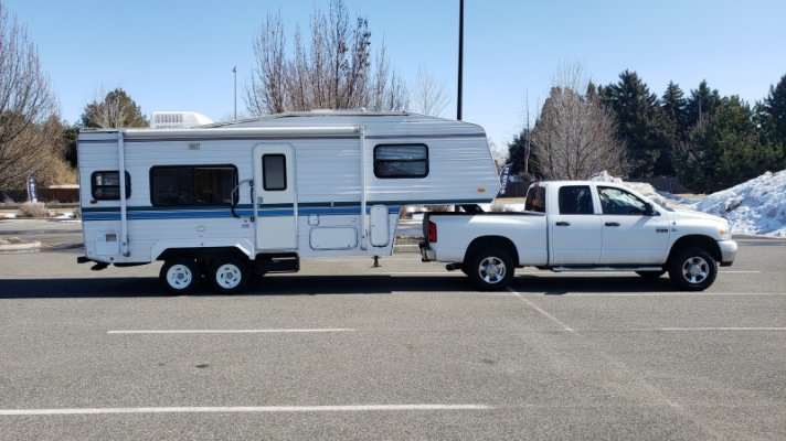

I'm very happy with the results. This truck is a beast, could hardly notice the trailer.

Looks good. I got the kit that bolts on also and it was still a pain! I dont even know how you would drill the holes, it was hard enough turning the bolts (on the drivers side anyways) - well worth the extra $80 or $100 whatever it was.
Question: it looks like your 5th is around the same size as mine (I'm 27ft) do you have a problem with bounce/porpousing? I took the 5th on a quick 5 mile drive with about a couple miles or so on the hwy at 55/60. I was getting a lot of bouncing. It wasn't a huge deal to me, but my wife gets car sick and I know she's going to hate it. I suspect it's either because I dont have enough tounge weight or the condition of the road. If I drive the truck by itself on the same highway if I'm going about 80 I do get some bounce going, so I'm hoping it's that, but I have no bounce there if im going 70. Unfortunately my water is at the back of the 5th so I cant fill it for more tounge weight, and it really sucks because I like to fill up at home and avoid filling up at the campground.
Next weekend I'm going to sanitize my water tank and tow it to a local campground to dump, so I'll get to see how it reacts with a bit more tounge weight in the gray tank, and then on the way home I'll see how it acts with empty tanks and no camping gear. We have a site booked for the 29th weekend, so I'll get to then see how it does with normal camping load, and if I still have this bounce I guess I'll have to look into some potential options. This "cheap" 5th wheel is nickle and diming me to death.
Edit: I should also say I drove through all the trouble spots I was worried about with the hitch forward, and cab clearance was never an issue. However, going through the creek crossings I mentioned in my first post, I came very close to the bed, definitely less than an inch - I thought I hit my bed rail, but I cant see any evidence of that on the truck or 5th. It's a dirt road and has some pot holes and is off camber, so experience may vary depending on which line I take. I'll probably pull it through with the hitch slid back next time and see if I get more clearance.
