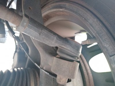

Don't take this as gospel, but maybe this is the reason or one of them.. There is a solution!
The tpms valve stem might rub the tie rod. Provided a pic below on my 20" wheels, -44 offset. If I put the valve stem cap on that, it will rub the tie rod and blow it, I will no doubt have a flat instantaneously. That's how close it gets. I imagine with a 17" being a smaller diameter, it could place that stem even closer.
However, they do have shorty stems you can purchase to solve that problem if that is in fact the sole reason.
