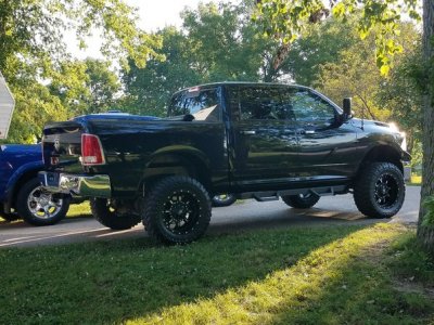

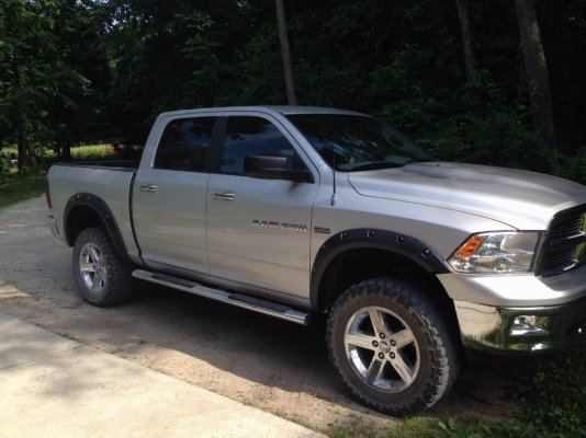

35's on stock 20's with 1.5 spacers. No rubbing. Also, I'll second the 5" rear coils.
Do you have any more pics of your truck. Say a side shot....... just want to see how far your wheels/tires stick out with the 1.5 adapters. Also truck looks good what's your total setup consist of.
Sorry for the thread jack.
Solid State
Apr 18, 2016
824
490
2011 Bighorn
Here ya go. Tires stick out about 2.5" past fender. I have a zone 6/5 with bils at 2.1, but just moved them to 2.8 about a week ago.

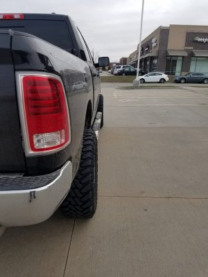

Here
JB1
Nov 3, 2011
8,366
7,542
Houston, Texas
So you have approx 8" front lift now?
post some new pics at 2.8
Solid State
Apr 18, 2016
824
490
2011 Bighorn

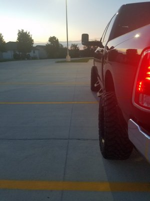

Approximately, yes. Stock front fender was right at 36. After front fenders are 44.5. So, 7.5 lift, and another inch for 35's.
Solid State
Apr 18, 2016
824
490
2011 Bighorn

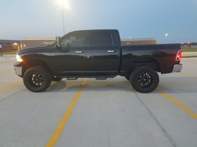

And the new wheels stick out about 3"

That looks great, I guess I missed it but what's the new wheel and tire specs?

20x10 Fuel Krank -24, 35x12.5 toyo mt
