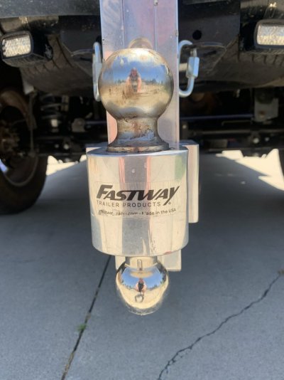

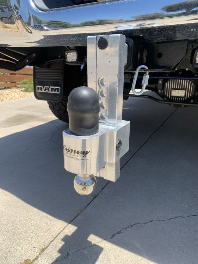

Here’s my set up:
2011 1500 2wd, 7” lift, 35” tires, 24’ enclosed car trailer which maxs out at 10k.
Went with a Fastway Adjustable Aluminum hitch w/ 2 & 2 5/16 ball. The hitch gives me up to 13 1/4” of drop, though I only need to set it at @ 8” setting.
I‘m very vigilant about weight, ads up quick, wanted something strong with good reputation, and something adjustable so that if I ever find myself needing to tow some else, that I’d have that flexibility. B & M has similar setup which is comparable as well.
Not sure of the drop you will need with the math. If it’s a true 6” lift (settling will occur and varies from manufacture) plus the increase of tire height ( 1/2 of 35-32”) 1.5”…….. I’m coming up with 7.5 optimistically.
Ive not had any issues what so ever, though full disclosure….. I am researching into a Weight Distribution Hitch (WDH) setup just because I like the added benefits of having one. My threads under Towing for what it’s worth :waytogo:
6291BADC-DFDB-4699-A2D2-83563744DB0B.jpegD05BFDAF-7FFA-451F-9EF3-5D84AA1301D0.jpegB1B7EF00-FD72-494E-AA97-25CDCD82F4B0.jpeg
