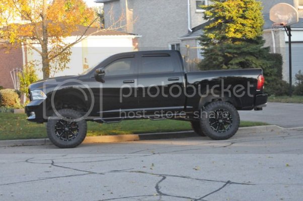

Hey Matt, thanks man.
Lifts always get me going...lol
To be honest...adding Bilsteins will scream for larger tires and Im sure that's not what you want as the Terra's do run a tad shorter than 37's
Unless that's the look you're after ;)
I'd run it the way it is and if you don't want the rake (which should be approx 1.5"-1.75") add the Bilsteins then at 1.4" to level
Here is mine with 37's, 6" RCX, Bilsteins at 2.1 and it screams bigger...so down she went. Lol

See I actually love that stance. Like the size of the tires there is almost the size of the fender well opening. I dont like the look of the huge tire that if flexed would hit the bumper or fenders.
I think I'm the only person who likes that look haha I think its sportier for some reason.
