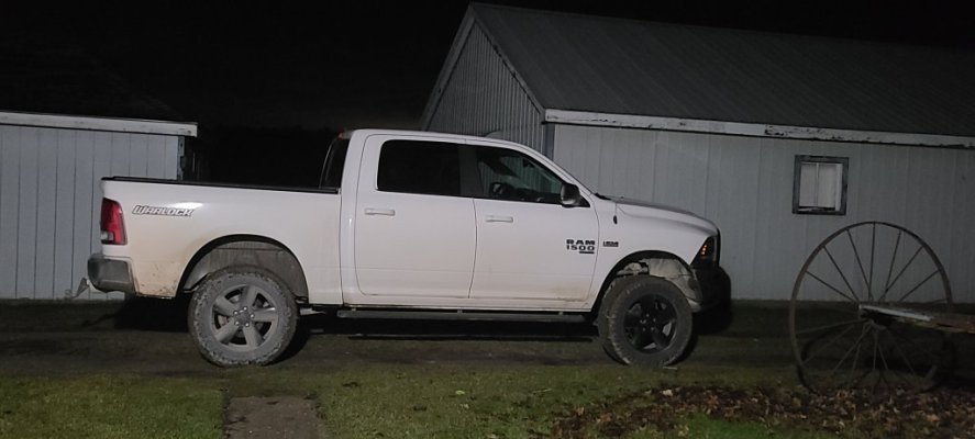

2015 Ram 1500 4wd crew cab 5’7” bed big horn ecodiesel. I have a 6” lift on the way right now from rough country, right now I have 275/65/20s on 20x10 -12mm offset wheels. Does anyone have pictures of a 6” with this size tires and wheels I want to see how disproportionately they will look? Also i already have 5th gen 2” struts in the front which comes to around 2.75” lift so I’ll have to get a new strut spacer other than what’s in the kit. After talking to RCX they said pretty much everything is the same between 4” and 6” kit, does anyone know what size rear coil spring spacer id need if I wanted to do a 4.5”-5” lift instead and what strut and coil spring spacer comes with it? Anything else I’ll need that doesn’t come with the kit to help all the suspension angles or give it a better ride?
All depends on what brand/kit you went with. They all have different options throughout the board.

Rough Country 6” 33231 with the strut spacer, and preload spacer IMG_6554.jpeg
