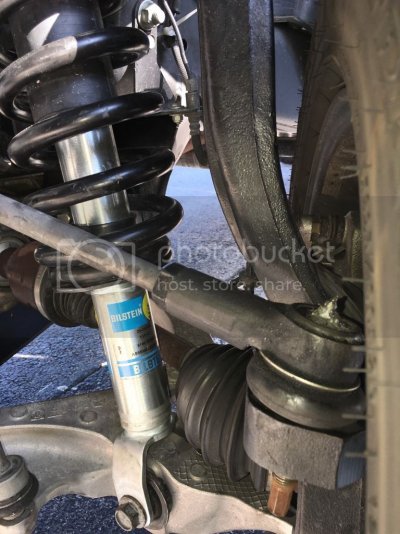

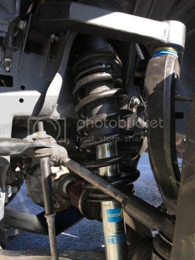

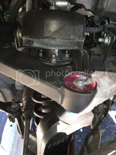

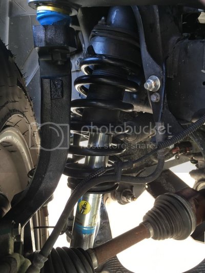

post a pic of the struts so we can see what you have and if its assembled correctly

Everything looks good to me as far as the Bilstein install is concerned. The preload spacer isn't there and the lower spring seat is installed correctly. I can't see enough of the bottom grooves to confirm what they're set at but I would guess they are infact at 2.1" as they should be.
