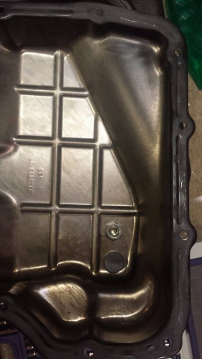

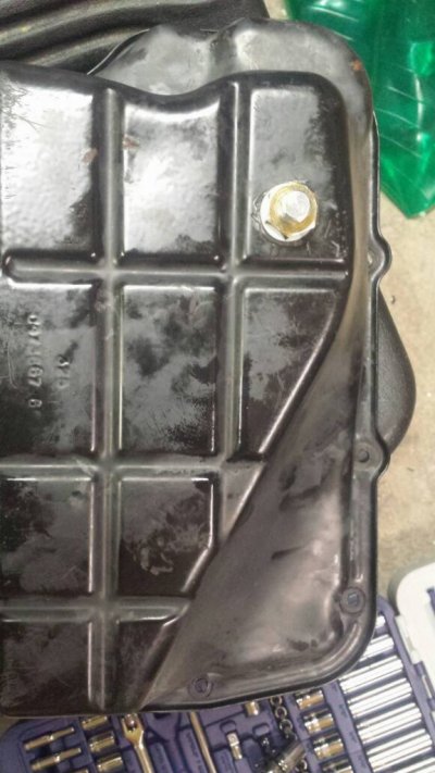

I switched back to the OEM pan with a B&M drain plug.
This is the best place I feel to put the drain plug as theres no interference with anything and it's closest to the bottom of the pan so most of the fluid should drain out. Installation of the drain plug was fairly straightforward. Be careful to only tighten it to 25ft/lbs max. Over tightening will cause it to leak. I went the extra step of putting RTV both on the inside and outside around the hole. Then I put some more around the bolt on the outside of the pan. I also used some Permatex thread sealer on the drain plug itself. For $12 you can't go wrong with this kit.

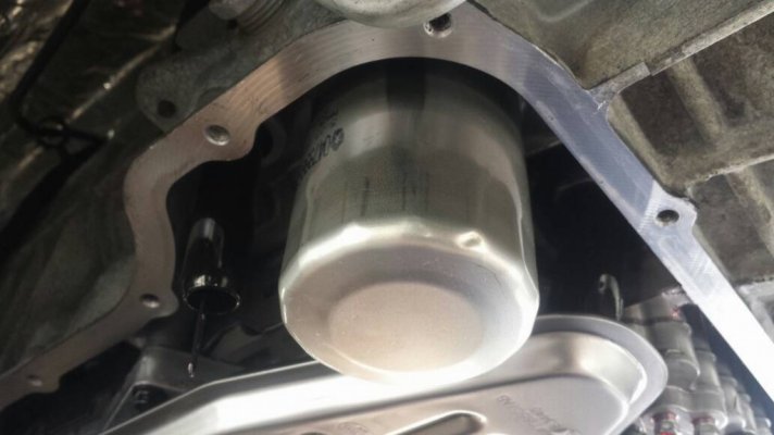

As for the Dorman pan, I found it doesn't have enough clearance on the side of the pan where the filters are and it was pushing on both filters. The main filter doesn't show any signs damage but the spin on filter has a few spots that are caved in. It was also not allowing the dipstick to fully be inserted into to the fill tube.
Not sure if this is just an issue with the 65RFE, but I would recommend against using it if you have this trans. It's too bad, it's a nice pan with a magnetic drain plug...
