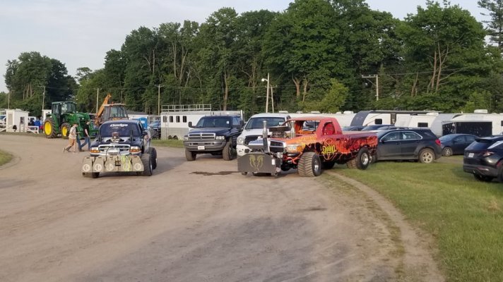

how much power you looking to push through that transmission? :patriot:
