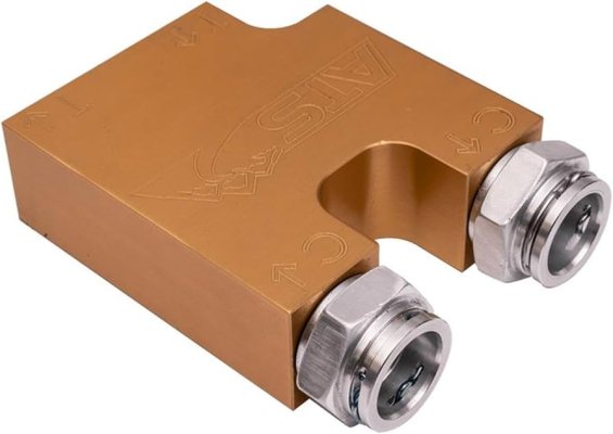

Since 2013 the RFE has had thermo bypass, this most likely is your issue. It seams you are aware, so all you need is to replace it.

I thought 65rfe didn’t have a thermo bypass, I’ll look again and if I see it I’ll take that off and see if it improves the temp
Look through the upper pass side of the grill,if you see an aluminium block with 4 hardlines running to it,you have the transmission thermostat.

Oh yeah, they’re pretty pricey too, I’ll try the bypass first and pray it solves the issue, next would most likely be have a mechanic do a service if it doesn’t fix the issue
I'd lay odds there's nothing wrong with your cooler,and the issue will be the thermostat block,they're known to give trouble. They use a light duty pellet style thermostat in the block,and my honest opinion of it,it's a piece of garbage.I disassembled the one off my old 13,and not only is the thermostat junk,but even in flow flow mode,it doesn't let all the transmission fluid flow to the cooler,as it's still a restriction in the cooler flow path.
I think the bypass will probably cure your issues,unless you have something wrong with the transmission itself.
