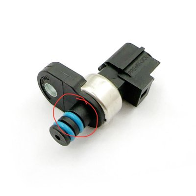

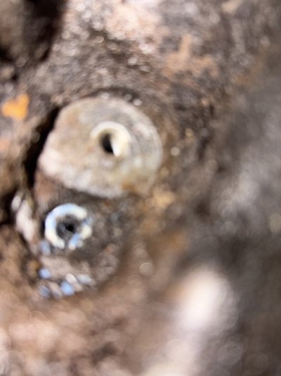

Not the best pics but this is what I got tonight
The sensor pic is circled where it snapped off

No luck with putting a screw into it, I will be bringing a torch home from work tomorrow and try that.
Might be stupid but how bad would it be if I was able to just push the broken piece off into the trans? It should just fall into the pan correct?
What was the issue with trying to put the screw in?
Broken piece spins?
Hole to small?
If hole is to small drill out larger.
If you don't have a left handed drill bit....coat the bit with grease to hold the chips on the bit when drilling.
Try not to drill more than 1/2 deep
