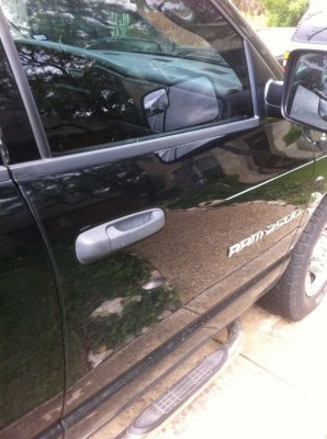

Wow - the closer I get to meeting this guy and hearing from you folks, the more & more wary I get on his ability to provide a "decent" paint job for $700.
Just to recap - he says he will spray 2 coats of base & 3 coats of clear.

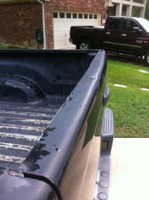

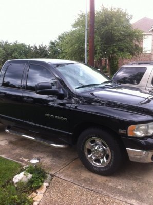

Here are some shots of my truck:

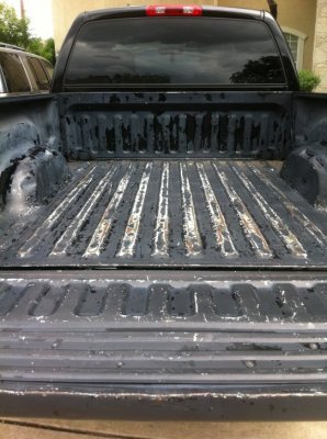

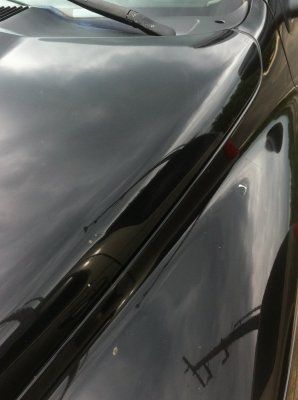

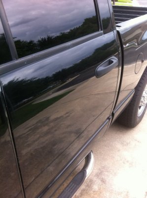

And some more shots:
