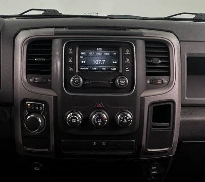

Thanks for the reply sir. If I’m not mistaken it’s a RA4 #68428539AC I got the harness from Amazon for a 13-18 Ram Uconnect 7-speed and I’m about 85% sure I do have a extra one just in case. The picture below was the original, but with a smaller 2.5 inch screen. i’m currently waiting on the back up camera harness from infotainment.
