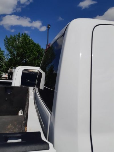

I am not exactly sure what you call a folding hard cover. I can tell you taht after shopping for a topper/canopy for my 2021 2500 8' box SRW the dealers selling canopies need to do a bunch of training with their staff. Most of them know very little. The 2019+ in the 2500 and 3500 all have the same bed dimensions. The biggest difference to the pre 2019 in the tailgate shape. The rest of the bed dimensions all the way from 1996 are actually very close to the same. See the thread I posted about Canopy shopping once it gets approved.
From the thread I posted on Canopies
A couple of interesting things, the 2500 and 3500 do not come in a Quad cab configuration any more. If you want an 8' box you get standard cab or crew cab. The Mega cab only comes with the 6' 4" box. Since I was originally having such a hard time finding a cap I did some measuring of my existing truck and a 2019 that was on a dealer lot. I don't know if Dodge did it on purpose but the length of the bed rails, width of the box and width of the Tailgate are almost identical on both trucks. Both beds are 71.5" wide at the front, near the cab, it tapers to 69" at the back near the tailgate. The Tailgate is 62.5" wide. This means that in all likelyhood I could just drop the 1996 canopy straight onto the new truck. The only issue is the rear door hangs over the tailgate on the 96, to form a good seal. The 2021 has that wide Whaletail flat spot and bump out on the tailgate. You would have to trim 1/2 to 3/4" off the bottom of the aluminum frame at the bottom of the door for the door to be able to close and allow the double T handles to latch up.
The back of the cab seems to have just a bit more outward bow to it than it did on the 1996 club cab but I doubt it is enough to affect fitment.
