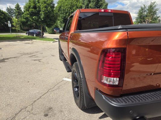

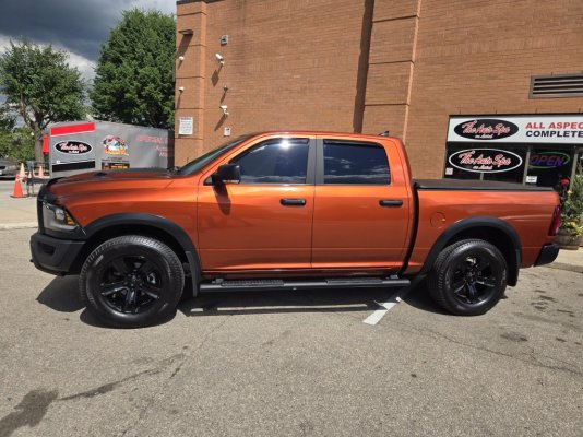

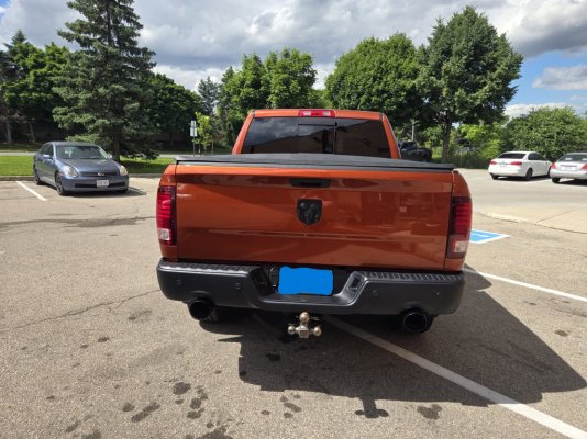

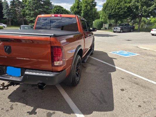

2023 Warlock
If security is necessary, hard cover for sure.
If you're just looking to cover your bed, perhaps look at the soft cover.
I've had the soft cover on my previous Ram for 5-years and it worked great.
No issues with snow or ice. Spending ample time in the Ottawa Valley and Quebec in the dead of winter with heavy ice and snow buildups and never an issue.
I also like the soft cover because it is super easy to remove by myself and tuck it in the garage if I need the extra bed space.
As for weatherproof sealing of my soft cover; you can adjust the clampdown tension to ensure that the cover seals are firmly seated on the bed box. I go through no touch car washes and have a few drops to no water inside my bed. I can live with this.
The caveat to this, in my opinion, is that the OEM MOPAR branded soft cover has the cross bars that are arced, and this helps with rigidity/stability of the cover. Especially with heavy snow/ice loading.
My buddy has a soft cover on his Ram and it's aftermarket and noticeably different then mine is in terms of build and design as his cross bars are flat across. He has some dips in the soft cover material itself from heavy snow/ice loading.

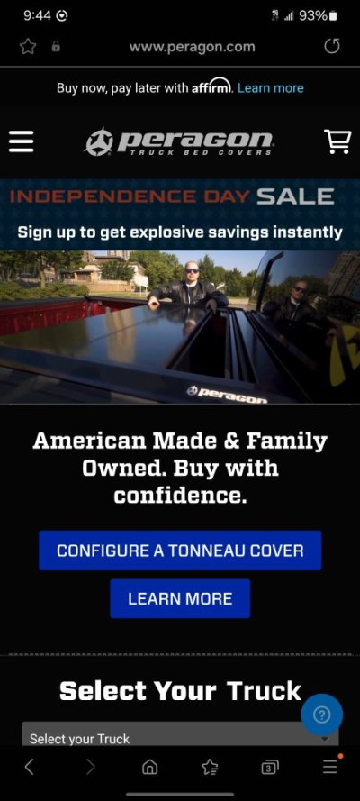

I have a peragon cover for the past 3 years it works great. It does lock and it can be removed easily if you need to use the entire bed it will fit in the backseat if needed. Its easy to install if you get the no drill kit. It took me about 4 hours to install. Its definitely not cheap but worth it at least I think so. I can take pictures of mine if you are interested. Goodluck Screenshot_20240630_094438_Samsung Internet.jpg
