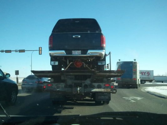

Trucks been grounded for a week and a half as i try and sort out what I done to her. Pretty sure I've located the problem but the reason she's on the Tow Truck is i want to make sure the Gears and drivetrain are OK and am going to have that checked out and at the same time install a new front driveshaft as that I think is the Noise Culprit I've been experiencing. Parts bought so far total just under $800 bucks with my Good looks Discount...:roflsquared:

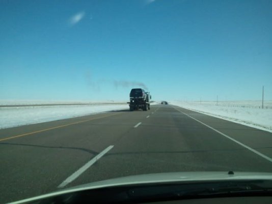

I was doing 80 MPH in the PT and you can see how far back I was.
Was i worried, ****-Yeah! Truck was in neutral with the winch chains holding her and the rear chains crunching down the leafsprings via my trailer Hitch.
The Tow Truck can do 140 KPH as tuned and they have another one that tows semi's and it can do 160.

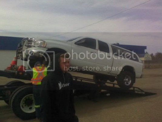

I know man its not a good thing to see that maybe why no one else has commented. Only thing kept me from crying like a Girl was the fact it looked cool up there and cudo's for the Tow Truck driver passing at least 5-6 Rams on the HWY.
I have free 160 K towing as part of my Canadian Auto Association Membership so may as well use it (first time ever) as its good security in the wallet, the member is covered regardless of vehicle when stranded (I could be hitchhiking and I'm covered).

I know what its like. Got lotsa looks too but the tow truck was much smaller than yours. When they tilted the deck back down with my truck on it, the front wheels of the deck truck just barely came off the ground.
