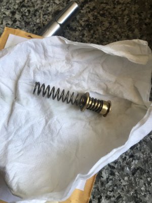

Just wrapping it up.:)Before I button up, that long spring from the back of the original does not go back in on the back of the new thermostat correct?
also, there were two t40 torx bolts holding on my shifter linkage. They were really in there with purple/red locktite.
the driveshaft bolts were 15mm with blue lock tite. Overall not too bad of a job. Excited to see my lower temps combined with my grille ******* mod:)
Edit: long spring on old goes one new??

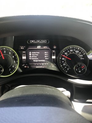

Hmm I though the results would be lower. I wonder if the 5th gens compensate more
Above is after fully warming up and WOT runs on the highway. Reached max of 195F on trans. Ambient outside temp in the upper 50s

I don’t think you put it in right. From what I remember the long spring does not go back in. I want to say it is just the small rod then your new plug. If you put the long spring under the new plug it would just hold it open and let trans fluid into the heater all the time.

Yeah I didn’t put the long spring in. When I tried to take it off the original tstat the whole thing fell apart.
I’m stumped no real improvement for me so far.

What are your temps? Should definitely be lower unless you have the grill shutters still. Those will keep the temps higher. My temps are 132° when fully warmed up cruising.
I have modded my AGS, only have middle and bottom slats no CEL.
I really beat on it and drove it like I stole it. My high temp posted is after that beating. The lower temp one was me being easy on it to warm up, was hoping it would stay there like you guys
I installed it just like caulks pics. Now I want to go to the 180 tstat. Or Maybe the 5th gens are a pita compared to the 4th gens :oops:

145° beating on it’s pretty good. I hit 152° after 4 back to back 1/4 mile runs. Lol.

Hmm, that's interesting. You are correct in not using any of the springs from the stock part. The plastic cap/plug and the pin are the only parts you reuse.
