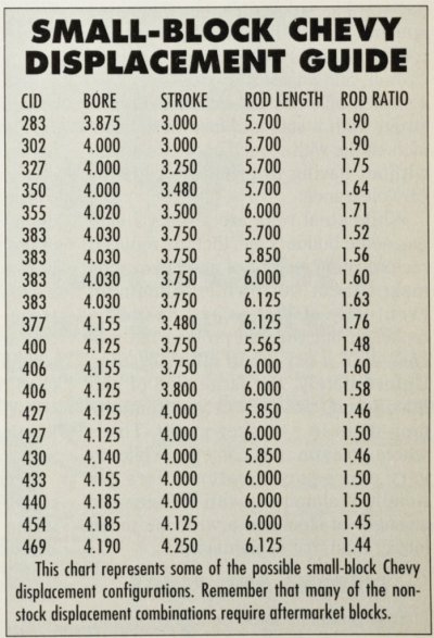

Yep.....1967 to 1969
302 had a larger bore than the 283 with the same 3.00 inch stroke.
Chart below shows the engines that were used for performance.
262, 265, 305 & 307 not listed for that reason

The 302 was basically a 327 with a 283 crank in it.The rod / stroke ratio was one of the reasons they'd take a pile of rpm and stay together/
Another good combo is the 377 built on a .030 over bored 400 block and the 350 crank,as it has the next best rod / stroke ratio,only downside is the siamesed cylinders which were prone to running hot and being a bit weaker
