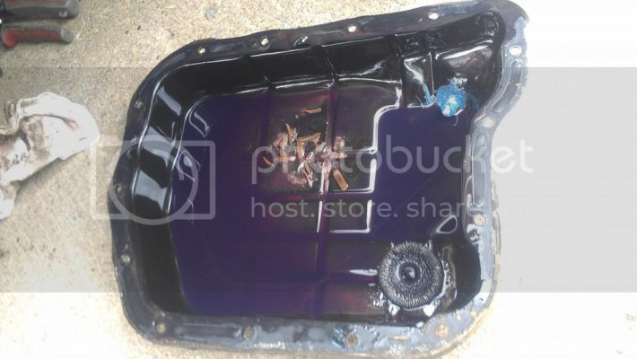

Well, ordered the parts. Dropped the pan. Found this.

Snap ring exploded :yucky:
No amount of adjusting can fix that. I see a rebuild in your future. On the positive side, if your mechanically inclined, the 46re isn't that hard to rebuild yourself. AND, there are relatively inexpensive kits out there to make them more durable than stock. Don't take those parts back, you will need those for after the internals get rebuilt anyways (never put the old ones back on a fresh trans).

^^^ Yep she is done. There was a Patc auto trany for sale in the RF classifieds you might have a look and see if its still for sale. It would be the last auto trany your truck would ever need.
