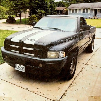

Just a little show n tell.
The day I brought it home brand new (plastic shipping covers still in place) and the day it went into storage. Can't wait to drive it again!
