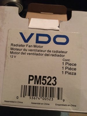

My 02 Dodge Ram slt 4.7 ac fan went out on my dodge truck. The cheapest fans complete I found were around $60 and all the Fan motors at Rockauto, autozone and the like we’re around $80.
well I found out today that there is a fan that autozone sells for $29 that fixed my fan. It was an exact replica of the one that came out of the fan housing. All the mounting points line up perfectly including the alignment stud.
The fan is VDO fan motor
Part#PM523.
I hope this helps someone
